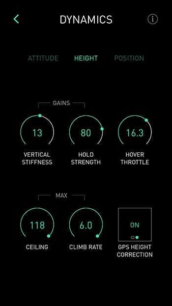

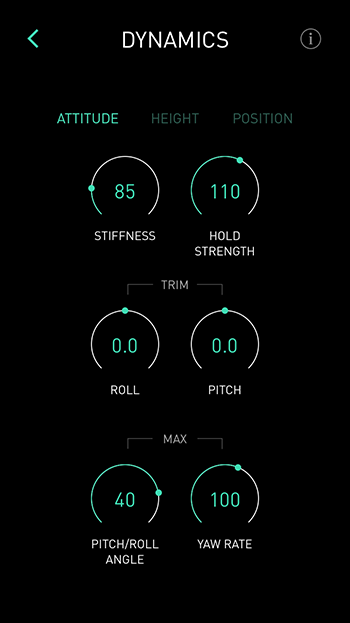

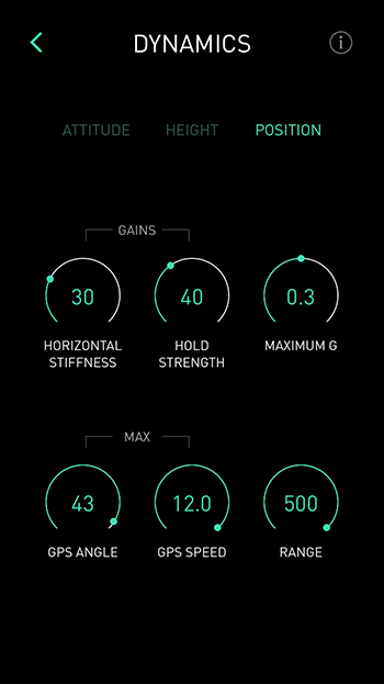

    Thanks for looking at this Tabb.
    Here are my settings...
    [​IMG][​IMG]
    [​IMG]
    [​IMG]

    So I see a couple of things you may want to adjust. GPS Angle default is 30. Not sure why it is set so high.
    Vertical Stiffness is low compared to default of 20. Yaw stiffness is below the default 100. It might be worth going back to the defaults.
    How did it fly with all of the default settings? While the GPS speed and climb might be low you have increased them which would be the correct thing to do.
